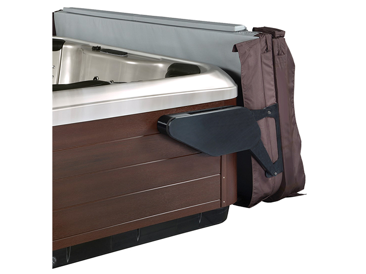

I know you said you want an "under the spa type lifter" but I cannot say enough good about the Covermate Vanish XL I have
At first I was leery about both attaching it to the tub as well as permanently attaching it to the cover. But after about 18 months of having it, it works great.
One hand operation, looks good on the tub, and drops the cover out of view (mostly) when it is open

Interesting - although I worry about the same ice-laden cover ripping that right off the spa ;) Of course, thats more a user-issue than an engineering issue.
It is held to the tub with a bazillion screws. Really, it is a lot of screws.
The gluing of the arms to the cover is what really concerned me, but whatever glue they use is awesome. I have had nothing even start to come loose.
They also sell just the ends of the arms where they glue to the cover. So if you have to change your cover, you don't have to buy a whole new lift. You just get the replacement arm ends that glue on.
