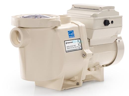

Ahhhh, ok, I think I was starting to come to that realization while reading more about that pumps features. So if I'm correct the pump below would work for my situation, though it's a 3hp rather than 2.7 which it will be replacing. I certainly hope this pump will work as it gets outstanding reviews and is much more affordable than a Jandy FloPro VS 2.7.

Note that Pentair says the 011056 pump is now obsolete and may be difficult to find. If you can pickup one then do it. Otherwise look at the InetlliFlo3 pump.

Do you happen to know for sure if the IntellliFlo3 can be controlled by the Aqualink system? I wasn't able to find the older version so had to get the 3 (011075) and so far I haven't had any luck getting the Aqualink to control it.
It's not the end of the world as I can still control the new pump via the Pentair app but it would be nice to have it work with my Aqualink system.
It's a really nice pump, super quiet and really nice that it has built in bluetooth & wifi.

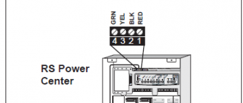

On the RS485, ensure you have the 2 wires correctly connected to the RED connector on the PCB.
see photo
The VS Pump RS485 connection is on the right - just the Green & Yellow wire.
So, the problem I'm having is that the 'old' Intelliflo's that are known to work require the cable that plugs into the pump and has the yellow/green wires to be wired into the Aqualink per the pic in the previous post. The Intelliflo 3 that I have doesn't have the socket for that connecting cable, rather, it has a 4 terminal connection per the pic below (which looks just like the 4 terminal connection on the Aqualink end.

You are correct.
You need to match up section 3.3.4 in the Aqualink manual...
with 3.3.3...
Which leads you to conclude that Pentair yellow wire goes to screw 2 Aqualink BLK and Pentair Green wire goes to Aqualink screw 3 YEL.
And the Aqualink connection from the IntelliFlo pump looks like...
The new Intelliflo3 pump dispenses with that connector, you can use any 2 conductor wire to connect it to the panel. On the Aqualink pin 2 is DATA+ and pin 3 is DATA- so connect to the pump connector accordingly.
I think the piece of info I'm still missing is how to hook up the wires on the pump end since I don't have that 7 pin plug that's on the old pumps and referred to in the pics above. Or am I missing something?
You have that right here. Pentair yellow DATA+ to Aqualink BLK and green DATA- to Aqualink YEL...
