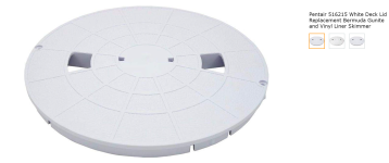

See below ... no real model number I can see though is does mention Pentair Pool Prod and address
I'm now noting the float valve diameter is small than the bottom of the skimmer (last photo)
... perhaps is is a incorrect replacement? Numbers on float valve: 8650-39
