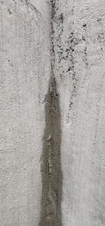

As I mentioned we've had some rain right after the shell was sprayed to the extent there is some water ponding in the yard around the shell.
I noticed what I'd characterize as weeping at one corner radius. It almost appears the water has carried some clay with it.
The other corners and the rest of the pool walls seems fine. Weeping is not usually considered a good thing when it's found in foundation walls and I don't see how it could be good here if down the road it's coming in behind the plaster.
Thoughts?Compress_20240214_083351_1295.jpgCompress_20240214_083351_1531.jpgCompress_20240214_083351_1758.jpg
According to this article some seepage is normal. I just don't have any context as what qualifies as "normal."
The seepage is fine as long as it dries up before plastering.
Point it out to the builder and ask them to put some hydraulic cement along the corner.
