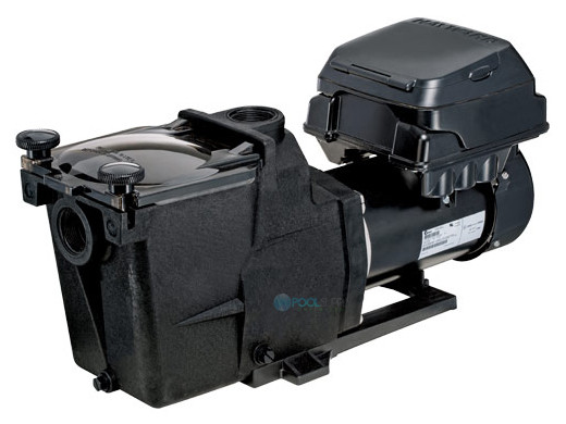

Just confirming, is this your pump?
If so, the motor is removable. I know because the wet end is very similar to the wet end of the Hayward super pump motor I replaced with a variable speed V-Green motor. I'm on the third year with the motor and I'm happy with it.
It looks the same. Mine doesn't have W3 as part of the model number however. The original motor says Century.
