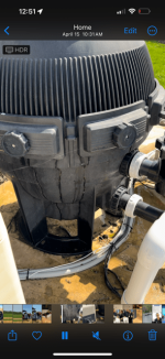

Had my pool opened last week. Was able to get things cleaned up quickly and its clear, balanced and running well. Except, I noticed that when the spa is spilling over into the pool for a couple hours in the morning, the filter leaks around the seams. Everything seems tight to me. I'm a newb managing my pool for the first time this summer, so any suggestions would be greatly appreciated!
What kind of filter? Where is it leaking (can you edit the picture to show where?)?
Thanks! I figured it out. There was a bunch of crud in the seal. The oring was fine so no need for replacement. Just needed to clean out the gunk and then it was fine. Thanks so much!
