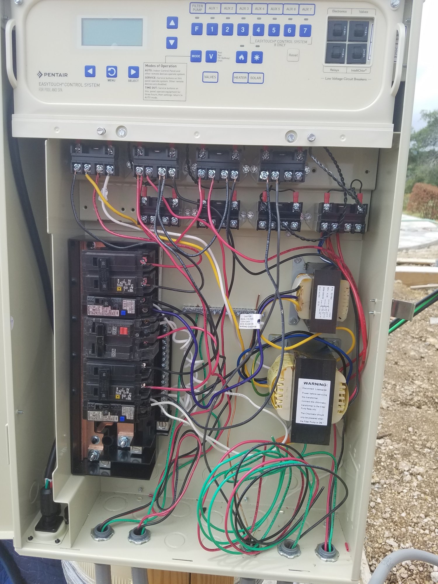

Here is a pic of the inside of an EasyTouch..

An EasyTouch is normally hard-wired to the main circuit breaker panel in the house.. It is basically a subpanel.
It is designed to have external things, like pumps or lights, etc, hard-wired into it via flex electrical tubing, which you can see in the above pic.
That does not mean that your electrician can't add outlets, it is just not how is it designed.
