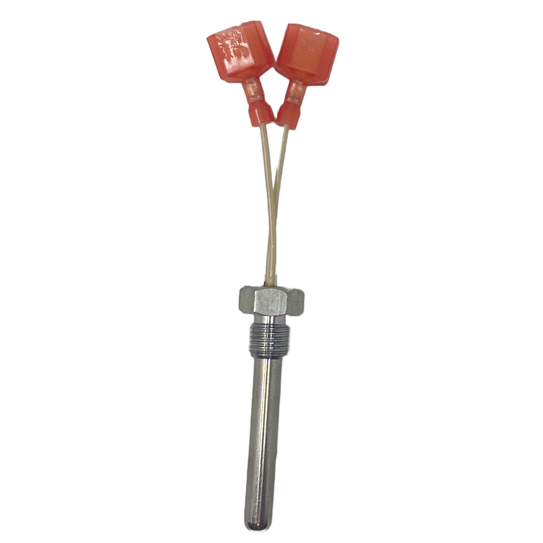

Just tested my old sfs and multimeter reading was 2.52 does it mean it's a good sensor?
The reading after disconnecting and taking it out was same o.l.
That confirms why you got the E05 error.
where can I buy legitimate one besides amazon?
For the Pentair price test it and return it if it does not test good.
Reactions: txmk4
I bought this one from Amazon for 89. Should I return it and order another one or use one of sites you suggested?
I would return it and go direct to a reputable pool store.
