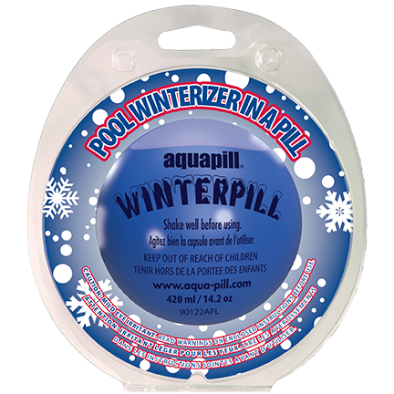

This is the second year now after using the winter pill that I have had issues getting the chlorine level back to normal come spring. Last year I ended up removing half of the water in my 15000 gallon pool in order to get it back down. FIrstly, why is this happening and how can I prevent it from happening. Secondly, how can I resolve this now without removing 7500 gallons of water or more. The winter pill has worked well for three years now keeping my water clear come spring but this super high chlorine level in the spring that I can't seem to get to come down is a major issue. I do not know the exact number of the free chlorine in the water because once I had added 50 drops to the sample I figure there was no point in going farther.
I use a Taylor FAS-DPD kit for testing and we use a SWG.
So far what I've done this spring was add salt to get back up to 3000 ppm, I made the mistake of adding CYA before checking the chlorine and I brought the PH up from 7.0 to 7.6 with one box of borax.
I greatly appreciate any assistance on this issue.

I have no idea what a 'winter pill' is ------------
I don't think that the pill contains any chlorine.

Those things don't have chlorine in them, even if they did they aren't large enough to hold enough chlorine to raise the FC by that much.
That leaves three possibilities in my mind:
1. Something in the pill is interfering with the test
2. The reagents are bad
3. Testing error
Regardless of what is causing it, if you closed with 5 ppm FC and haven't added additional chlorine, you do not currently have chlorine in the pool. Do you have one of those yellow OTO color match chlorine tests? If so, run a sample through there and see if you get any reading.
The pill doesn't contain chlorine. So, where would any chlorine come from?
