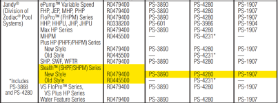

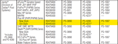

I replaced my 2 speed pump recently but had to go with the old seals since the kit I bought from Amazon was not correct. For the life of me I cannot find the information I need to get the correct seals. The ones from the new kit were too small. The motor did not come with new ones. Thoughts?
Part # 5020-087
Manufacturer Code R0479400
Alternate Part #'s PS-3890, PS-4280, PS3890, PS4280, PSR-3890, PSR3890, R0479400, 35-295-1160, JNDR0479400, TLD-101-2032​
Product Description​
Shaft Seal 5/8" R0479400
The Saltwater/Heavy Duty version of this shaft seal is the PS-201V-CMS
Jandy Stealth SHPF & SHPM Series Pump Note:
  • Used with serial number P08FF0001 and later.
Also fits Zodiac Jandy ePump variable speed pump models JEP
Fits ePump models
  • VSSHP270AUT
  • VSSHP220AUT
How To Select the Shaft Seal for a Jandy Stealth SHPF & SHPM Pump
If the serial number is before P08FF0001, the correct shaft seal is part number 5020-086.
If the serial number is after P08FF0001, the correct shaft seal is part number 5020-087.
In our example, the serial number is N07FK2715. The correct shaft seal would be 5020-086 because the letter N is before P in the alphabet.
If the serial number started with S, the shaft seal would be 5020-087 because S is after P in the alphabet.
LOCATE SERIAL NUMBER - Find the label on your pump housing that displays the Jandy model number and serial number.
The serial number in our example is N07FK2715.
Note: Do not look on the motor specification label for the serial number of the pump.
SELECT SHAFT SEAL BASED ON SERIAL NUMBER -
Step 3​
OPTIONS IF NO SERIAL NUMBER - There are a couple of options if you are unable to read or find the serial number.
1) Order both shaft seals and return the one that doesn't fit.
2) Measure the ID of your current shaft seal. If the inside diameter of the shaft seal is 13/16", you'll need part number 5020-086. If the inside diameter of the shaft seal is 5/8", you'll need part number 5020-087.
Note: Option two would require you to dismantle the pump in order to measure the existing shaft seal.
