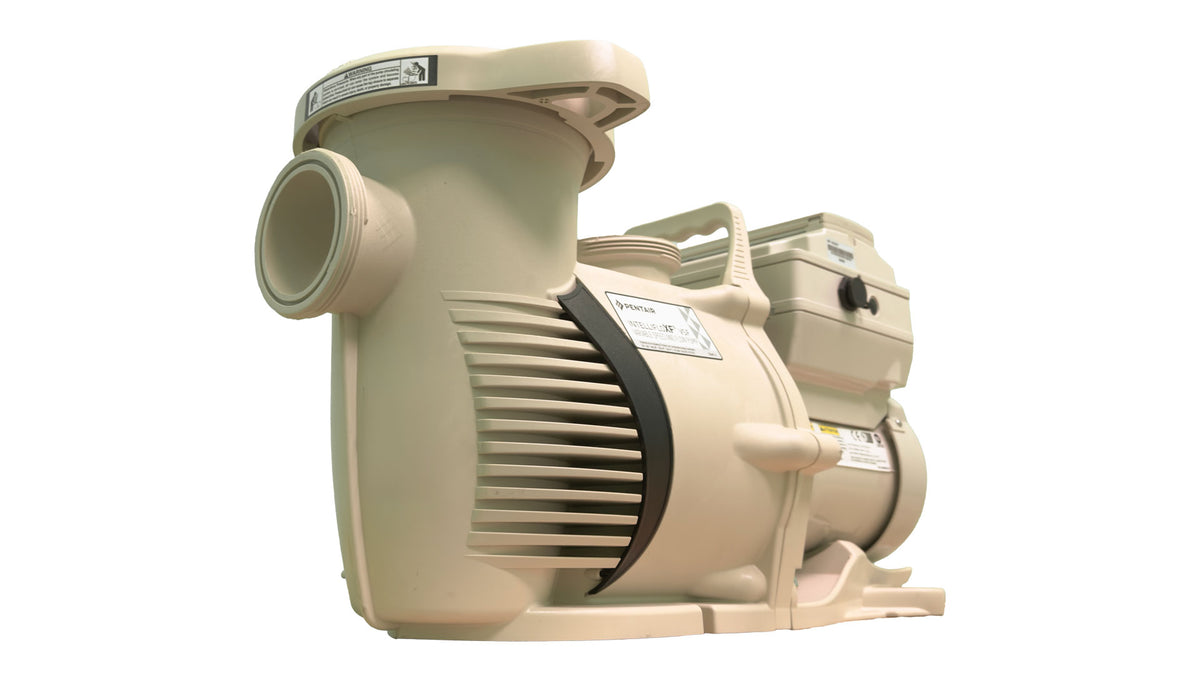

Finally an opportunity for a little bit of give back on this forum. With some support and encouragement from my friend @Jimrahbe I purchased this new Intelliflo3 VSF pump mostly because the previous model was infinitely backordered. I am so glad I did, so far I love this pump! Here is my review and a few pics:
I have used Intelliflo pumps at my previous home and came to love these pumps. Theres plenty of information on the site about Intelliflo pumps in general, so rather than bore everyone with every detail I focused mostly on the difference from my previous generation IntelliFlo:
Pros:
  • Efficiency: At approx. 1200 rpm this pump moves 22GPM in my pool and uses only 135 watts!!! I expect a huge energy savings over the Hayward I am replacing.
  • Ultra quiet: I am used to quiet with my old Intelliflo at my previous house but at 1200 rpm I have to touch this pump to know if it is on. It is near silent up until close to 2000 rpm
  • Mobile Friendly!! If you are not using other automation this utilizes either blue tooth or wifi to control via the Pentair Home app right out of the box. Connection/setup was super simple. Scan the QR on the pump, download the software and it guides you through everything. No more squatting down over the pump mounted control panel!! There is an external WiFi antenna built in and the reception was excellent! I was able to get my 2.4Ghz nearly as strong as I can inside my house. Even if you are using automation, this pump provides real-time status, information and alarms through the Pentair Home app.
  • Automation friendly: As expected, with a 2 wire hookup (not included) this hooks up to Pentair automation which overrides the unit controls. If you put the Pentair automation in service mode, the on-board pump logic/programming will take over again.
  • Price: With the Covid backlog expected to continue through the summer the price of this unit is about $1500 resale, less than what I could get an old Intellflo VSF/VF for.
  • Flexible: Accommodates from 1 1/2" all the way to 3" in/out piping. Comes with all the adapters for different sizes. You can buy optional relays and use this as a basic automation system and program remotely through the app.
  • Install: Easy peasy. Uses the twist on couplings for easy removal = no leaks. Very accessible high and low voltage connections from the top cover.
  • Alerts: Through the Pentair Home app you can receive alarms and notifications and you can also have your pool pro notified. The catch seems to be that your pool pro must be a pentair registered pool pro to show up in the list.
Cons:
I'm hard pressed to find flaws with this pump. My previous Intelliflo was not a VSF so not sure if this was always a limitation but my VSF unit doesn't translate utilization to RPM through the Pentair Home app, which is what I was used to from my previous Intelliflo. You can however still use RPM based programming from the Pentair Automation and it will translate. Instead this pump uses % utilization or GPM. Honestly, I am getting more comfortable using GPM anyway because everyone's piping/flow is different. If my filter gets dirty and slows the flow, this will adjust itself automatically if set to GPM.
Just got this installed yesterday so if I find any more cons I will add them but to me this thing is Dang near perfect.

Hey Jim,
For this pump there are three buttons on top, you can probably just make them out in the pictures, so I attached a new pic. They are "connect" "On/Stop" and "Quick Clean" They have different colors to indicate different states and the connect button changes to magenta when its being controlled by automation. I put a picture of the color map that comes affixed.
As for the basket, yes, it's huge. Picture attached.
You are correct about the controls. From the Pentair home app main dashboard and from the individual device screen you see: GPM, Speed %, and estimated wattage consumption. From the screen logic you can see and set by either RPM or GPM (but not by % Speed). If you click the RPM/GPM button it will toggle and show one or the other as you set but at the bottom you can see both in terms of actual utilization of the pump.
