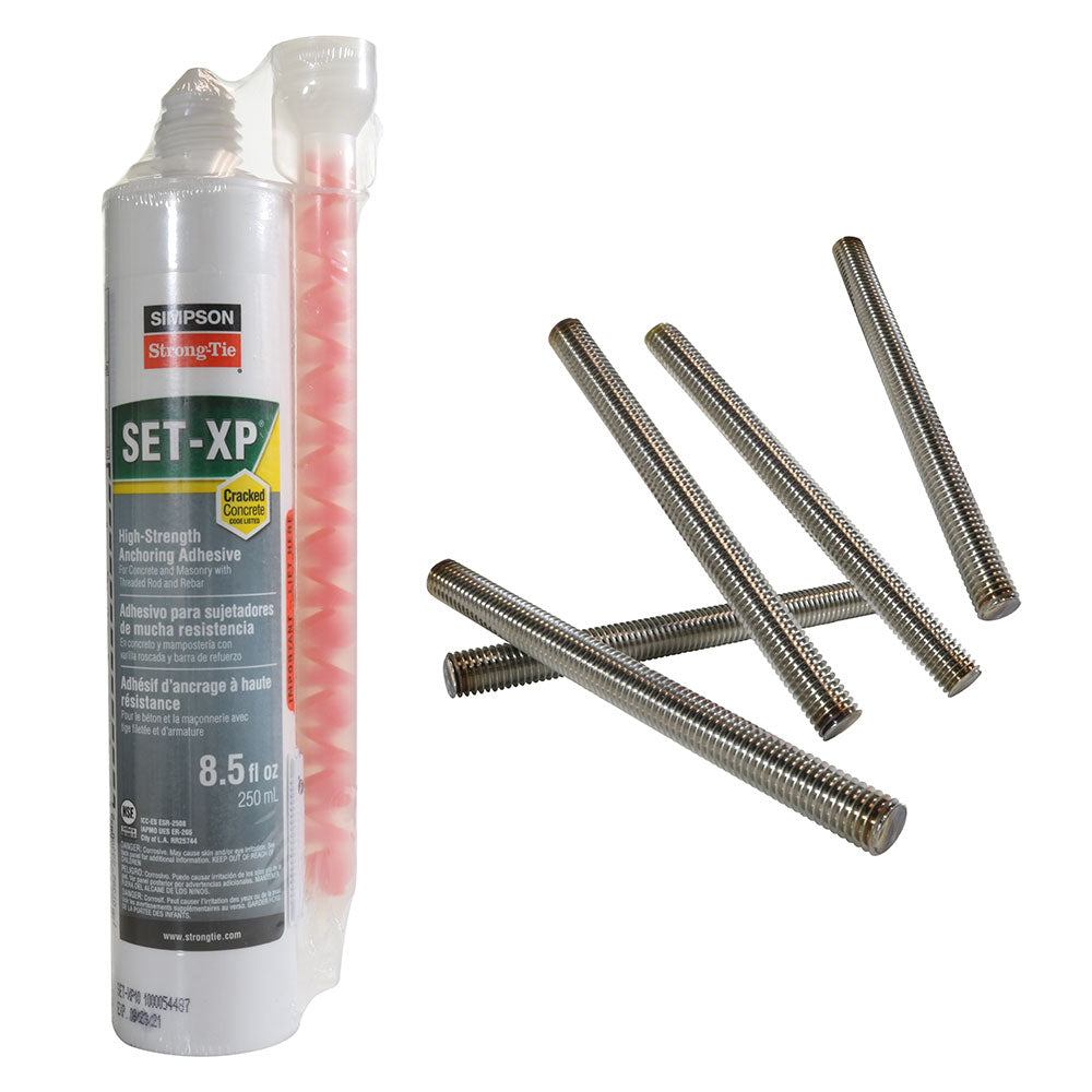

Yes, I would drill holes next to the old bolts and then epoxy a bolt into the hole (like they do with diving board bases):
Reactions: LouiseT
