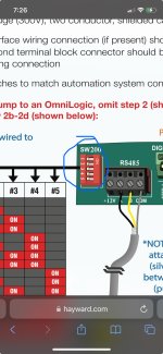

Yes only 1 HUA for a pump is visible. There should be 2. Open the pump where the comm cable and power go in. 4 screws below the control panel lid.Keep the breaker off to the pump make sure all the dip switches on the blueish dip switch contact are all on 0(off). In between the power side and comm side is a metal divider with a sticker that has your HUA on it. Try to delete and add your pump back to your configuration.

Weird how they are working with the dip switches up on both. This is the HUA sticker circled. Flip the dip switch on the pump that isn’t working down like in the picture I sent leave power off for about 10 minutes and look at the sticker for the HUA. Leave the other one alone since it’s working
