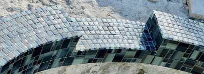

June 3 to June 7 - Coping and Tile Installed
Within four days, a crew of four came and cut my deck back by two inches (since my new coping is 2” wider), then they installed the coping which took two full days, and over the last day they installed all the tiles.
Some previews of the tile and coping:
More photos coming soon!
  • Love
Reactions: PCR and kimkats
