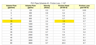

Note that the hole needs to be sized according the the desired flow rate and the amount of water level in the spa that is acceptable to be above the pool.
For example, if the flow into the spa is 15 GPM and the hole is 1 foot of 1.5" PVC pipe, then the water level in the spa will be about 0.18" above the pool water level.
1.5 x 12/100 = 0.18" = (about 3/16") (4.572 mm).
For 25 GPM through 1 foot of 2" pipe, you get 1.2 x 12/100 = 0.144" (3.6576 mm).
So, a 2" PVC pipe with an FTA (Female Threaded Adaptor) on both ends will allow the spa to get continuous fresh water and the threads will allow you to plug the hole from either side and heat the spa independently.
