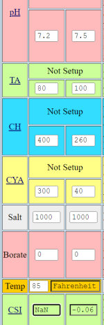

I recently test a new pool which had the following readings:
FC 15
pH 7.2
Alk 80
Cal hard 400
Cya 300
Temp 85
Pool math is showing 0.00, levels look good but when I bring Alk up 10 it goes to -1.24. This water obviously needs work and draining but why would it show 0, looks good?

If the pH = 7.2, TA = 80 and CYA = 300, the adjusted alkalinity is 80 - (300 x 0.26) = 2.
Due to the high CYA, the carbonate alkalinity is basically 0 and that is causing the calculator to give inaccurate information.
You need to get the CYA to 80 ppm or lower.
Reactions: mgtfp
I have found that when using Pool Math and CYA is above 250 and the CSi gets close to -2.0 then it starts to default to ZERO.
It seems not to calculate a CSI lower then -2.0. Maybe @Leebo has some insight.
Also, using the recommended test kits, it is very difficult to actually measure CYA above 200 with any accuracy. Pool stores and other electronic test kits may try to calculate high CYA values. .
With such a high CYA, the “acid” component has a huge negative effect on CIS calculations.
At this point the math is rather unreliable and not trustworthy. I’m not sure why it’s reverting to zero as a default when it’s basically throwing its hands up in error, but I’ll make a note to check for next update.
It is the base component that is affecting the CSI calculation.
The cyanurate alkalinity has to be subtracted from the total alkalinity to get the adjusted carbonate alkalinity.
If you subtract about 1/3 of the CYA from the TA, a CYA of 300 means that you are subtracting 100 from the TA, which give a bad result for TA levels of 100 or lower because the carbonate levels are 0 or lower.
