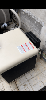

Hi. Thank you for your response. I tried to upload higher res but it doesn’t let me go higher than 1MB. I’ll try to do better. Those last two pics are from the last failure. In the one picture you can see some rust staining on the drum and a broken seal. And the first picture you can see the blower intake blows off. Was just showing that. The gas line coming in is a 1” line, picture attached. The heater is a 125, so a 125,000 BTU. Professionally installed by a recommended installer of Pentair. Not sure what else to say. I’ve gone through 3 in 4 years.
Your gas line is a 3/4" line, you measure the inside diameter.
Has anyone checked the incoming gas pressure? If it is too high, it will "blow" past the main gas valve when it is open (it can only regulate a certain amount of pressure measured in inches of water column, with a maximum of 10 or .037 psig.) and fill the combustion chamber so fast that you can get "explosive" combustion that can blow the venturi off the air blower. Have only ever heard of it one other time, and those heaters have been around for over 30 years.
I’m going to ck these numbers and the incoming gas pressure. Thank you.
There is actually a specific gas pressure check process that involves three measurements -
  1. Static pressure relative to atmospheric pressure on the input side (typically no higher than 11-14” WC)
  2. Dynamic pressure relative to atmospheric pressure on the input side (once the heater is running), typically no less than 4” WC but no higher than 9” WC
  3. Pressure differential across the valve (typically -0.2” WC)
These gas pressure conditions need to be satisfied or else the combustion will either be lean or, in your case, explosively rich.
You also should know what your incoming utility service provides - gas pressure and maximum flow rate. There are many different options for residential gas setups and sometimes the output of the gas meter is setup to be a “high” pressure line that then needs to be regulated at the particular appliance. It is entirely possible that your service pressure is too high and that is causing these failures. Only a properly certified gas plumber can and should do these checks.
