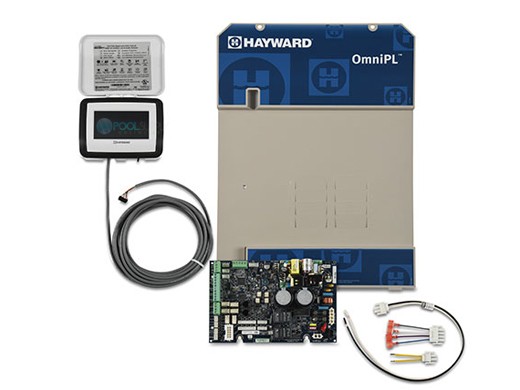

Omni PL Upgrade Kit Hayward Automation
Update: bought it and installed it and it's awesome! It was super easy to swap. I had to spend some extra time because of making a new cable to place the display where I wanted, where there was already some wiring for an old display. Scheduling options are so much more flexible, and of course the ability to control everything from my phone is worth the price! Oddly, my lights used to only swap between purple and blue when doing a fast on/off cycle, but now they're slowly changing between all colors! I have no idea what kind of lights I have though, and it's a little harder to do an on/off cycle quickly without physical buttons. Anyway, if you're sitting on an old Aqualogic, I highly recommend grabbing one of these before they disappear!
How far where you able to extend the cable? what size cable and how many wires?
The cable that comes with it is 15 feet. I didn't extend the existing one, I replaced it completely with wiring that was already run through the walls from my pump area to the spot I wanted the box. The distance is actually way less than 15 feet. I believe it was 6 wires, very small like 22 AWG or so.
