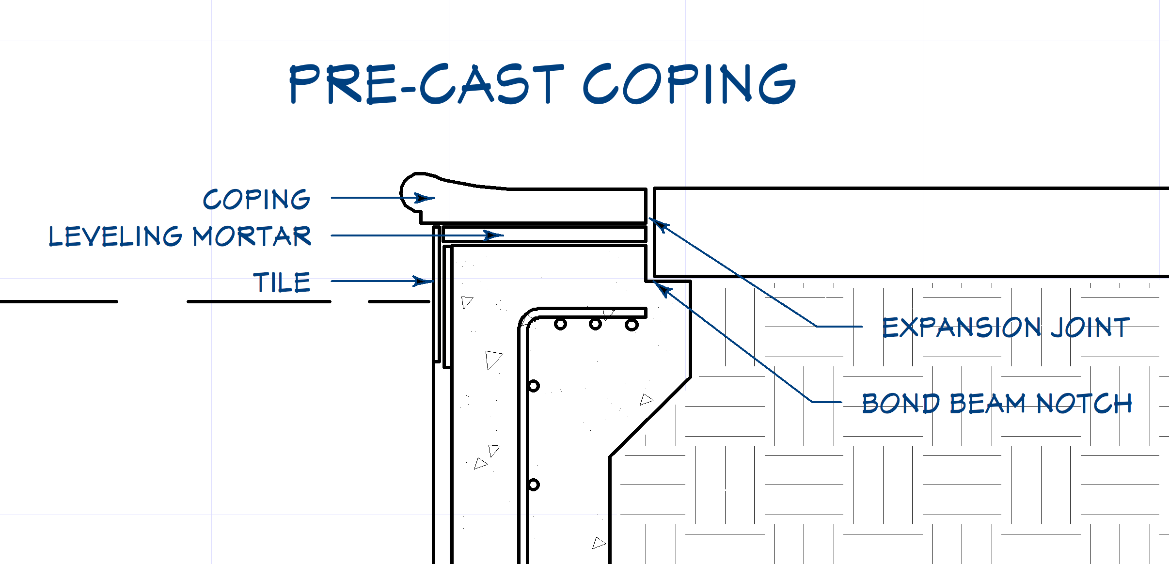

Can you provide a picture of effective area?
The deck work is not to come in contact with the coping, an expansion joint is to be in place to let the deck work move independently from the coping.
If the deck work is in contact with the Bond Beam when expanding, the Bond Beam will crack due to the pressure applied to it.
The deck and pool need to be able to move as two independent structures separated by an expansion joint.
The deck putting pressure on the pool structure is what causes the cracking you get.
That cut-away and link helps but I still have no idea if it was built right to begin with.
