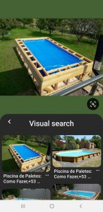

Hi. I find myself in a similar situation. What did you decide? I am thinking of building a treated wood frame support and adhering the veneer to it..as well as a support for the coping. I got a 5k quote for labor only for the retaining wall.. didn't include all the material needed. No Thank you. This is for asthetics..I don't need the big wall. Maybe something similar to the pic below.

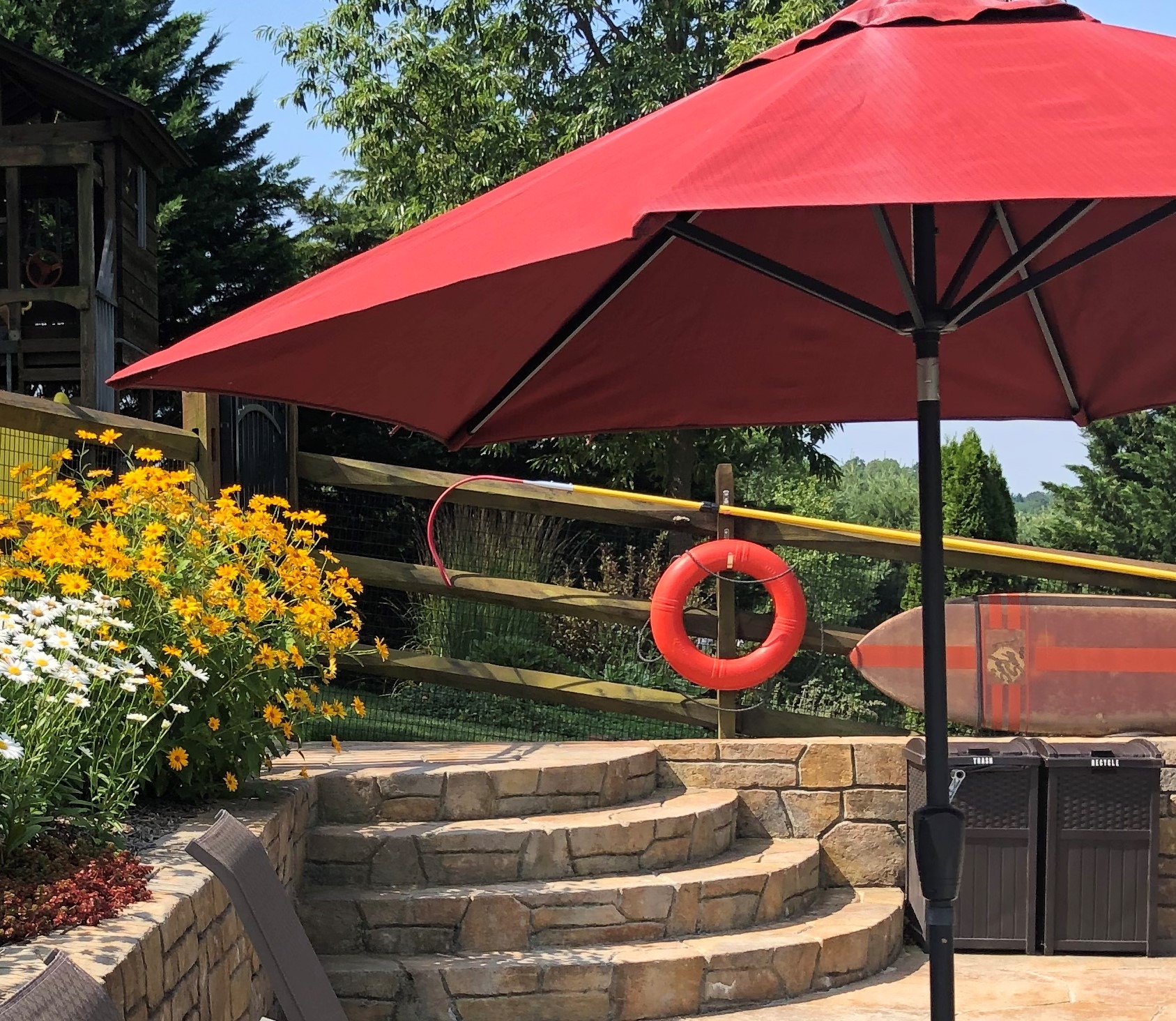

The vertical concrete approach could be a practical solution. You mention not wanting a Jersey barrier alongside your pool. Well, if you carve the concrete before it hardens you end up with beautiful stone look walls. My PB used a product/process called Stonemakers to form the walls below. The additives allow them to place concrete vertically without the time or expense of forms, then carve it. It is then stained for whatever look you'd like. You could also do some integral steps at the same time around the pool. The steps in my picture are done the same way as the walls.
