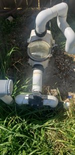

Here is some more information. I had a filter replaced. The filter when brand new ran at 5 PSI. I shocked my pool with bags of shock the day after I got my filter but I poured it directly into the skimmer and left it running for 5-7 days something like that. I noticed my waterfall was getting dryer and the water pressure fell to 0 on my filter.
I turned the system off and realized the shock had settled into my skimmer piping and hardened. I managed to scrap away and chip away at one of the skimmer channels and free'd one. Not all the way but enough for water from that and the bottom of the pool to get into my system.
So I know my normal running pool should be 5 PSI and it hasn't been over 1 since I barely unclogged the system.
Water runs through the system in picture 3. But i'm assuming its not as much as it should be b/c my 1 PSI and also b/c I can literally see the scrap away at a clog in my skimmer pipes

Are you getting flow out if the returns with no air bubbles?
A suction side leak. Is there air under pump basket lid?
Normally, using Pool Lube - Further Reading on the gasket for the pump basket lid will solve suction side leaks.
Is that the clear thing I see water in? Its not always full or water...sometimes half water and half air. But when I turn the pump off water starts to overflow out of there non stop
I wish I could just nuke this whole pool. Waterfall turned off...water pressure back to 0 PSI after I had turned it on for a few days. So now everything is back off
yes. It should be and stay full of water.
You are pulling air in at that lid or before it. That air builds in the filter and then pushes out through the same leaks when you turn the pump off.
