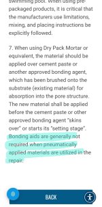

I'm the builder.
The gunite company said they would come fill these voids. Do you think that this is an acceptable solution? I'm just concerned with bonding issues.

See if the plaster company prefers to use plaster or to have the gunite filled in first.
What plaster mix will you use?
See what the plaster mix manufacturer recommends.
