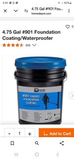

The alternative is some sort of waterproofing coating, but in that case I would want to make sure it is meant to have masonry over it. It appears you had tile in the area before.
