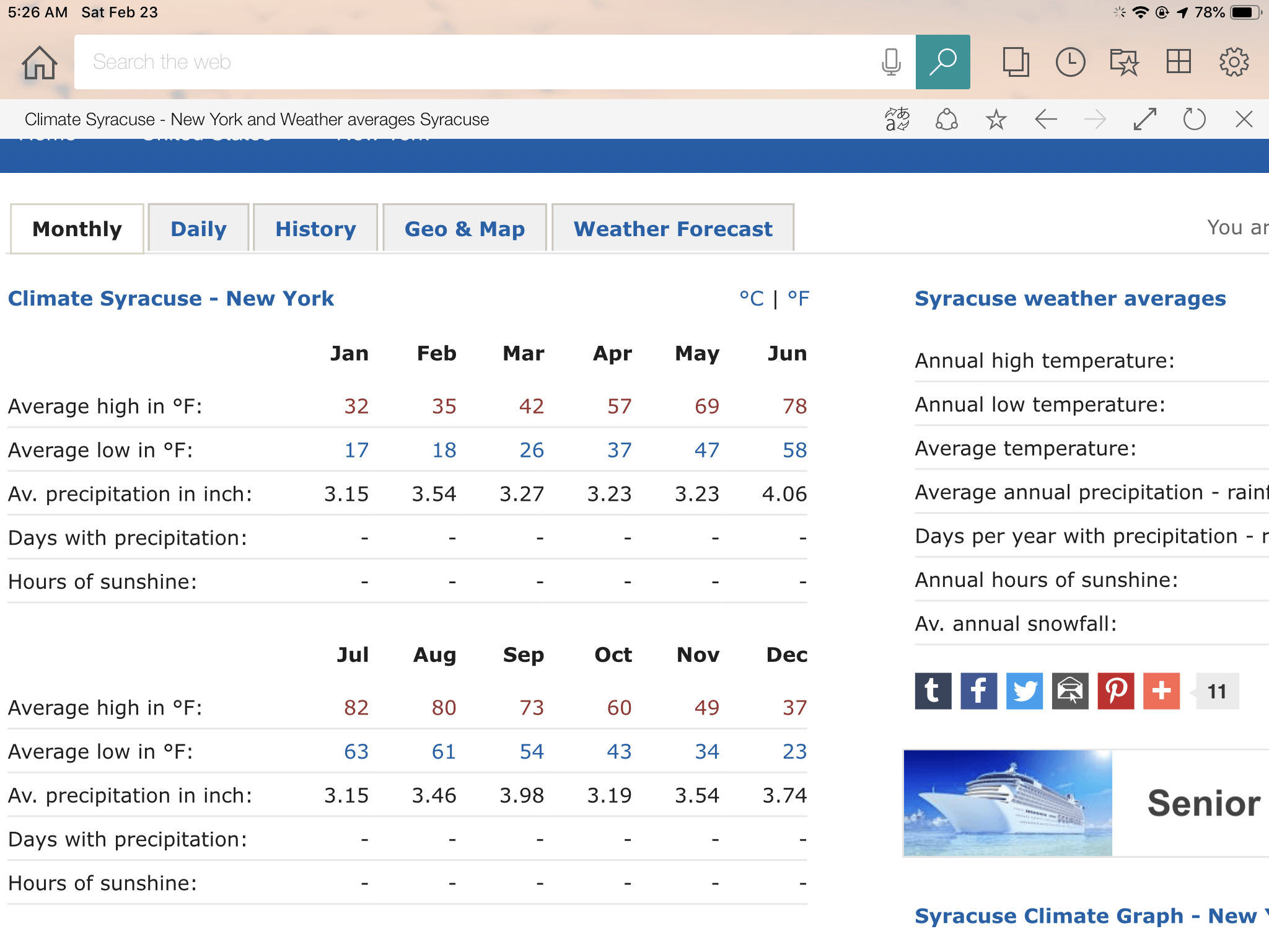

The two pictures below show the challange of a HP in your area.
A 140K BTU heat pump may raise the temp of your 24K gallon pool by 1/4 to 1/2 degree an hour during the warm hours of the day. You will not get maximum performance out of the HP most of the time.
I doubt the HP will do much for you in May. Once your pool gets up to desired temperature in June the HP should be able to maintain the temp if you are diligent about covering the pool when not in use. The HP may give you another 2-3 weeks in September depending on when it starts getting cold.
A HP will likely work fine for you when we have a warm summer. When we have a cold wet summer it will likely struggle.
