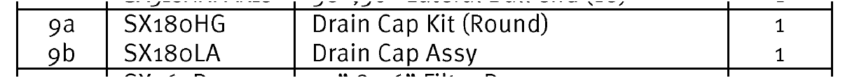

I would guess it's just pushed in (not sure from the inside or outside). Below are a couple of images from the manual. 2006 and newer look like the strainer is threaded in. Kind of looks like the back side of the cap can be used to install and remove the strainer.

Thank you for the response. It was installed in 2019 so should have the threaded cap. When I used the drain cap key to remove that was the first break. I guess I will just keep chipping and figuring out ways to get it removed from being jammed. Thank you again.
