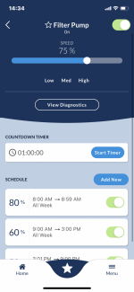

Running a new pool and having issues with the scheduler on a OmniLogic Pl
I have scheduled 3 different schedules in the OmniLogic. Staring out at 80% for an hour in the morning then decreasing to 60% for 8 hrs then 50% for 4hrs.
Pump turns on and off any the correct time but always turns on at 75%. Schedule shows up on the Hayward app and in the wired controller at the Omni.
Have deleted the schedules and put them back in several times using the app and the hard wired controller.
Every time it’s reverts back to the 75% setting.

it ran at 60% for a few minutes . Went back to the app 15 min later and it shows it at 75% again.CC166553-B420-4803-BFFF-F3D666B9592A.jpegCC166553-B420-4803-BFFF-F3D666B9592A.jpeg3FFA8DD6-BA41-4089-8564-F4988DFF4F60.png

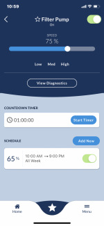

The pump is set to turn on at 10am at 65%.
it turns on at 10am but runs at 75%.
Went out yesterday. Deleted the schedule. Turned the pump down to 65% with the wired controller. Reset the same schedule . Pump ran at 65% until the schedule i set told it to turn off.
Pump came back on this morning but Omni reset 7A3FDF94-DDAC-42F4-B221-695F4F313DE9.pngthe speed to 75%.

Found the issue!
Finally Spoke to the guy who set the Omni up.
He set it up to run at 75% when the bubblers are on. Turned the bubblers off the pump runs at what is set in the schedule. Turn the bubblers on it auto sets the pump to 75%.
