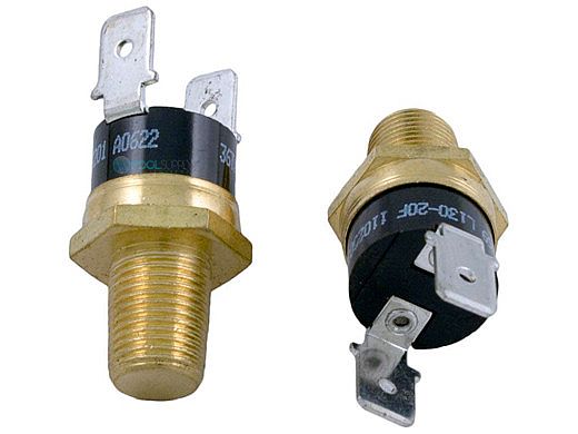

99% of the time LO can be a problem with the pressure switch which is located in the upper right hand side of the heater under the top front panel where the display is at. Locate it, remove the two wires from it and using another wire, jumper the two of them together and try the unit. FDXLWPS1930 is the part number for the flow switch. You can also find universal ones usually on Amazon.

i jumpered the wires that i removed from the sensor power cycled the unit and fired it up …… same error LO
I then jumpered the two contacts on the sensor- in case i wasn’t reading your post properly and same error message
so it appears its not the flow switch ……..

2) So a second question….. my pressure sensor that you had me jump the two cables……. One of the connector stems is loose - so i am thinking i should just replace that sensor….. its the one on the upper right corner- that has wires that connect to the outside sensor(i have circled it in the photo). That connector post is loose….
