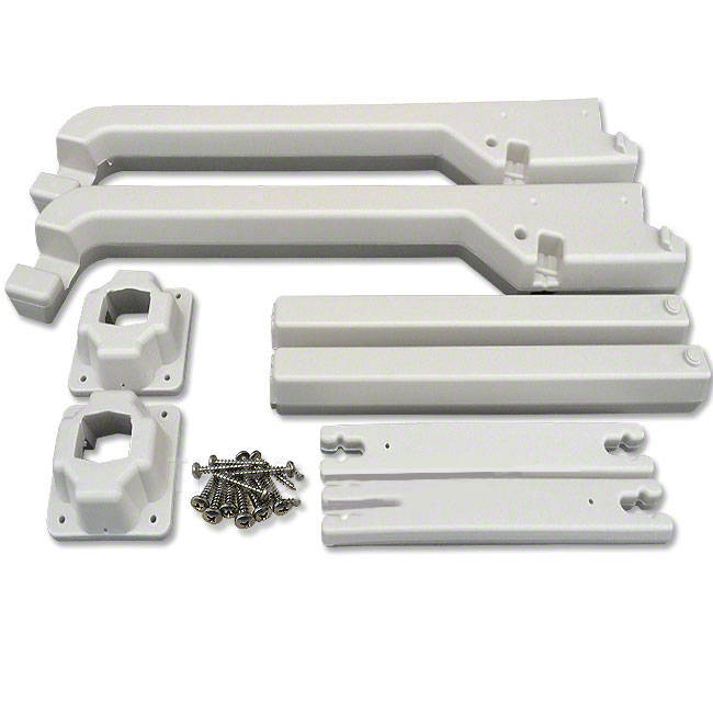

The "correct" way to do that is to get the parts the covert those from a over the rail to a deck mount.
Here is an example
You will have to find one that fits your particular stairs. Calling the Pool Wharehouse is a good start, they can be very helpful in hunting down the right parts.
Or you may have to build a small step up to the top rail, take the legs off, and attach the ladder to that step.
This is what I did with mine, because I did not want to screw them into the deck, since I remove them in the winter. They just clip into those notches
