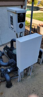

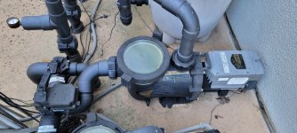

Here are some pictures of all my equipment. I added the pool filter and pump information to my profile. I see a few gauges on my system. Not sure which one I would need to check to answer Bama Rambler's question. The Caretaker doesn't have a gauge attached that I can see.

What you have is an Ultraflex system. When the system is on, do you see the motor in the valve top running?
The last picture you posted is your filter and the gauge on top is the filter pressure. What does it read when the infloor system is on and off?
What does the automatic valve on the left looking at the filter feed?
What do the two gauges in front of the filter read when the infloor system is running?
In this picture, the valve is open to both return lines. One shows 5psi and the other appears to be zero. Can you confirm if those readings are with the pump running, and at what pump speed? do you know where does each of those pipes (with the gauges) leads to in the pool? One must go to the caretaker system, and the other?

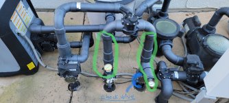

Let's try a little experiment.
Take the automatic valve on the left and see if you can rotate the handle straight up (If you can't, just run the experiment with it where it is). Then take the valve that's in the middle of the picture between the two gauges and turn it so that the handle is pointed inline with the left pipe. Turn on the Caretaker system, then let us know if the heads pop up as it rotates through the zones, what the filter pressure reads and what the left gauge reads?
20230218_111424-jpg.473916
Do you have wall returns in addition to the floor pop ups? If so there is a possibility that you could bypass the infloor cleaner system and only use the wall returns for circulation. I do not see any valves on those 2 front pipes but one appears to have a check valve. Can you confirm that and what is mfg. Name?
  • Answer: What would wall returns look like? I can verify if I know what I am looking for. Also, which two pipes are you referring to? I can look for a check valve if I know which I am looking at.
There are only 2-5 wall returns positioned on the wall of a pool (depending on size). Whereas there are multiple floor returns on a infloor cleaning system. See drawing
The 2 pipes circled in green with pressure valve that reads pressure in each line. There appears to be a check valve on the line on the left.
