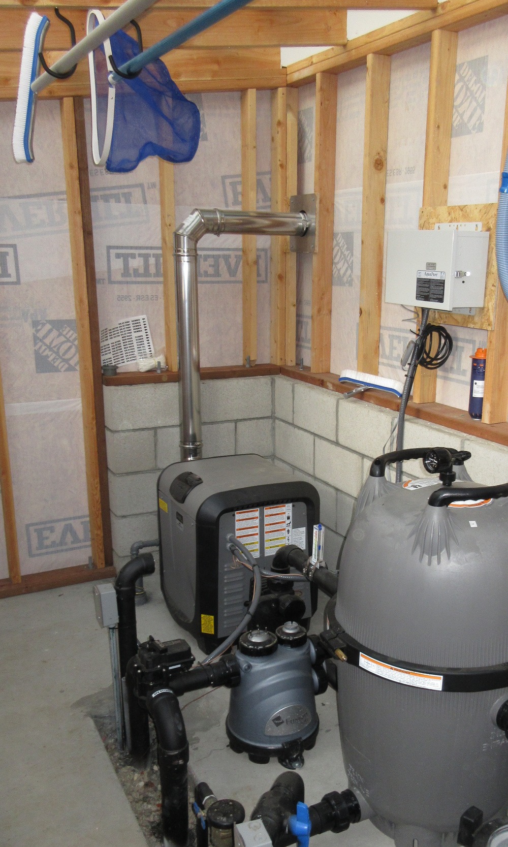

We put our equipment in a shed for multiple reasons. The primary one was to get it out of sight because the HOA rules were not going to allow it in our utility side yard (too close to the neighbors) and also required the equipment to be enclosed by a wall for noise abatement. But the added benefits IMHO are the equipment is sheltered from the California sun (which can be brutal on plastics), there were a few elements of our equipment (specifically the VFD that drives my swim current) that would need an additional enclosure if outside. And it also gives a convenient place to store the pool stuff (brush, robot, chemicals, etc). I did use fairly transparent roofing ("Solar Gray") so there is good light inside, and also note that the eves are totally open for ventilation. There is also a drainage path for any leaks or water from the equipment.
