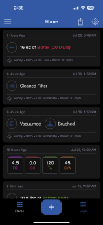

By clicking "log addition", PoolMath just creates a chemical addition entry.
You have to create another test log entry by clicking the + at the bottom of the main screen:
Reactions: Leebo
The idea is to create a log entry with the latest test results. Then the overview on the main screen will show all current levels based on the latest test for each parameter. Then you can click on a parameter and calculate required chemical additions, that will then be logged separately by the "log addition" button.
