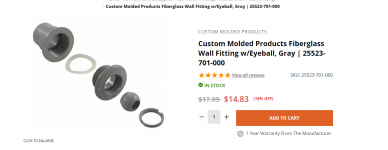

Is this the same?
It is probably a standard thread, so you can just switch to a different eyeball with the same thread as shown in the video.
Put some pool lube on the threads to make the eyeball easier to remove later.
Reactions: Mdragger88
Yeah, it’s basically a simple 1-1/2” FPT wall return and the eyeball sits in it with the retaining nut. I was hoping to replace the nut and eyeball at the same time. Alternative I can use any of the standard 1-1/2” male wall returns on the market but I kind like the fact that there’s no big chunk of plastic sitting on my pool wall.
