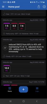

2 weeks back I was starting to think my cell was failing. Was having to crank my cell
Power up more and more to maintain a FC of 5. My CYA was around 50 and I bumped it up to around 80 or 90 and with no other changes my FC went to around 13. Have since turned the power down to around 30% and it’s perfect.
Similar thing happened last year and I wrote it off as a fluke but SWG like a high CYA.
