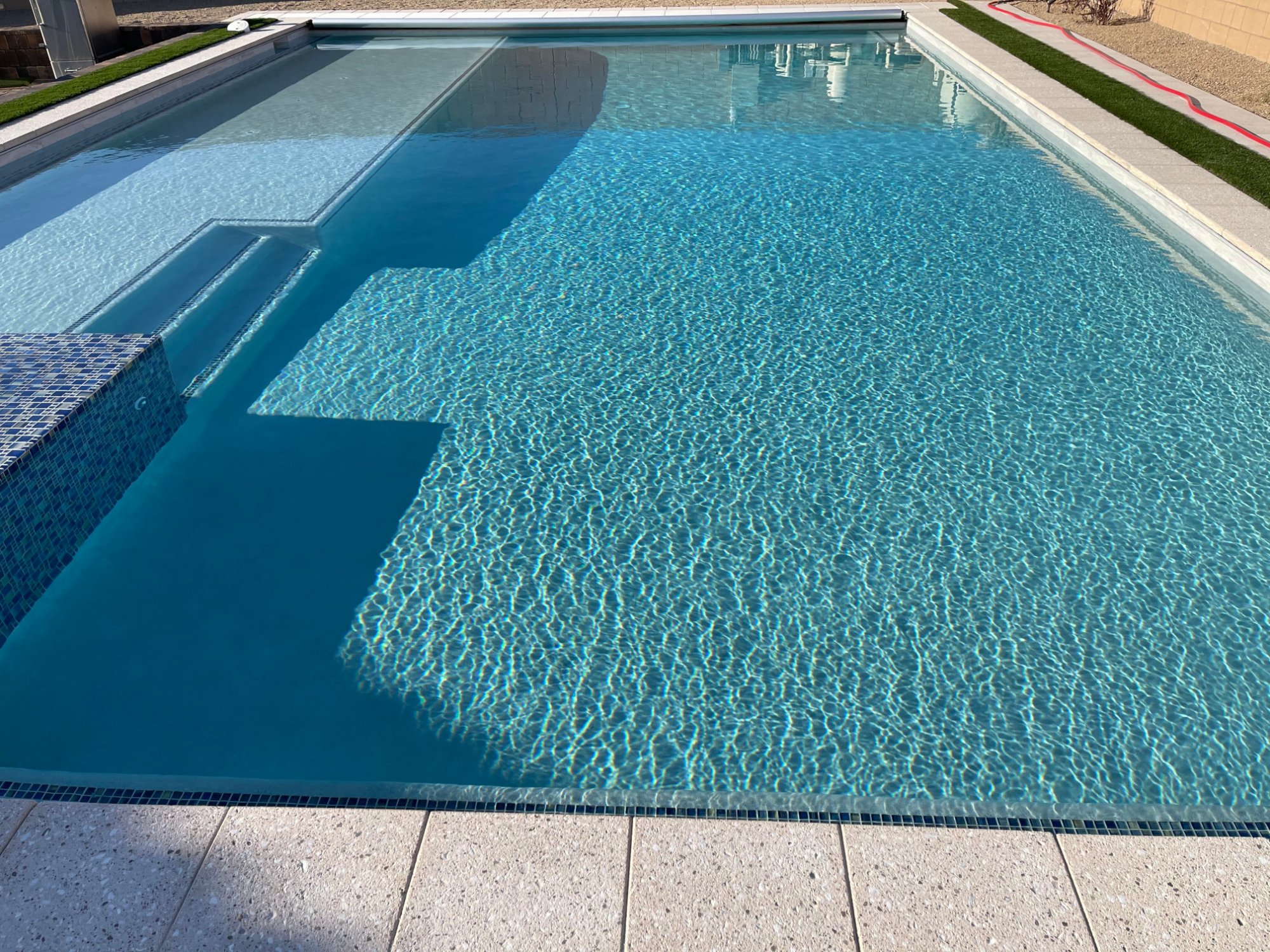

Welcome to TFP! I can not speak on why or how acid washing is done to quartz finishes. I know that I saw that onbalance post and decided I did not want an acid wash. Fortunately, for me my plaster contractor did not do acid washes after completing the job anyway. We selected a similar color and love the look.

@an1vrsy lovely pool btw, did he do his normal process and then just skip the acid wash? My contractor is telling me that it will be blotchy and the milk will be coming off for a while
The plaster contractor does not do acid washes after quartz application. For us, by selecting a lite color finish with blue quartz crystals, we do not have blotchy or mottling. As far as I know, darker colors are more prone for displaying those issues. Good luck!
Sounds like you made two good decisions; choosing a light color finish (far better than a dark color pigment), and choosing a knowledgeable and good plaster contractor.
This looks amazing. Can you give me the details on the brand/color used? Who was your contractor? TIA!
