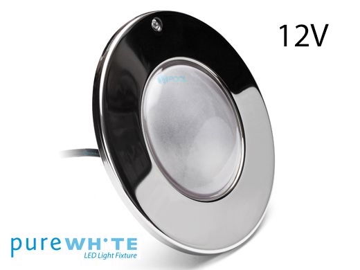

StaRite lights were SwimQuip before being purchased. There are some that are advertised as fitting SwimQuip, like this at Pool Supply Unlimited:
You might contact them, or J& J directly to see if it does fit that StaRite/SwimQuip niche.
There is one place advertising that light. The price, if they actually do have it, reflects its scarcity:
