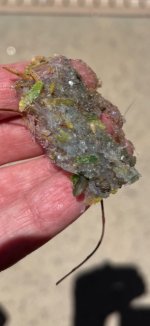

Thanks to this forum I fired my pool are company because my pool was developing algae and they told me “This pool is prone to algae.” LOL. I took out all the pucks, ordered the Taylor 2006 c test kit and have just passed a SLAM two days ago and am letting my FC drift back down to maintenance level.
Latest test results:
FC 22
CC 0
CYA 60
Salt 3700
CH 370
TA/Ph - did not do because if I understand correctly the results would not be accurate with FC above 10.

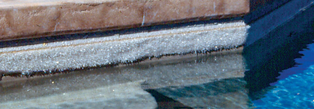

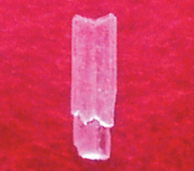

I put a drop of Muriatic acid on the crystals and didn’t see bubbling. Same thing when I let this dry to a white flakey powder.
When I squeeze this mess it sort of disappears or shrinks. Test results below. 17000 gallon SWG pool- newly replastered 4 months ago. Tucson, AZ.
Thanks for any advice!
