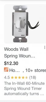

There are lots of different options of analog & digital timer switches
816D9F40-23DB-47D7-BC42-F33AD2006FE6.jpegCCDEC81A-FC50-4C45-84A6-3A1362B283C7.jpegF3808A9F-6B3B-4F1A-B2BA-C8A4A47339F4.jpeg
As well as wifi smart switches if you’re looking for something like that
