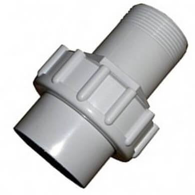

I give up for another day! I tried 4 wraps, no wraps, still the leak. What’s weird is it’s always from the 1 o’clock position; I tried tightening, loosening, always weeps water from the same place. I’m going to take the mpv off again and inspect the thread in case something’s stuck in it, maybe a bit of sealant or something.
The male end of the union is seated solidly against the base of the female thread, so I’m not tightening it any further! Maybe I could stick an o-ring in there..
If you have tightened the male fitting until it stops the fitting is damaged and possibly the pump. You should always see about three threads exposed in a properly tightened fitting. Pipe fittings are tapered and "expand" as they go into the female threads.
Six tight wraps of Teflon tape and a bit of silicone sealant has worked for me for decades of installations.
This is a multiport - brand new, not cracked.
There's 7 threads total on the union, which is one of these:
even dry I can easily screw in 6 3/4 turns and there's no threads sitting proud of the fitting
I wonder if the union is undersized or damaged somehow? I've ordered a new one just in case
it's an Astral 00599 - one of these
so if it's BSP .. and the union is BSP.. two parallel threads .. how would they ever seal without an o-ring?
So my replacement union arrived and it is actually BSPT which functionally is like NPT in that the threads increase in size.
Fitted that and no drips after an hour, so fingers crossed we’re all good!
