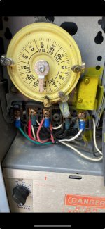

i’m set to replace a 30 yr old T104 timer.
Not sure what small box is on the right.
do i need it still?
new timer doesn’t have one.
many thanks
The box on the bottom with the knob is for freeze protection. The knob sets a temperature when the pump will turn on.
