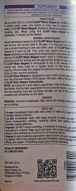

Show us pictures of the bottle and ingredients in the copper floculent you added.
A sequestrant does not remove metals from water. It just keeps metals in solution so they do not deposit on surfaces. And they do not lift metal stains that have deposited on surfaces.

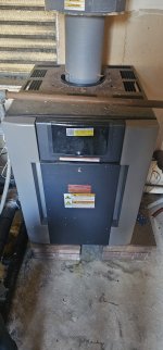

What model heater do you have?
How old is it?
Shows us pictures of your equipment pad.

I believe the Raypack furnace was installed around 10 years ago. After the initial service we suddenly had problems with the furnace. The plaster turned brown, then eventually blue, and shortly after pump went out on the furnace. The plaster/pool company installed IPS vidapure controllers, that have quite frankly caused more bad than good in my opinion. It seems like it just has a mind of its own halt the time. Our weekly pool servicer added the metal magnet and some pouch inside the motor skimmer. He said it'd eventually turn orange, but I haven't seen any color changes yet.
