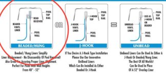

Liner-
If you are going to have a deck you may want to get a beaded liner that doesn’t require you taking the top rails off to change out the liner later.

Liner-

Gotcha. I'll look into both the cartridge filters, especially if you're telling me that it's less work. But I'll definitely look into that. When I talked to the township they didn't say anything about filters... so I might see if that's okay.
In terms of liner, I was thinking about splurging for the Round Uni-Bead Beach Haven Liner - 40 Gauge. This way, it'll be thicker. Is that the beading you're talking about?
Will definitely take the SWCG advice. I feel like I'm at the point of "TAKE MY MONEY". But I guess the upfront cost is inevitable.
Thanks!
For liner if that’s the gauge the pattern you like comes in go for it. Any 20 mil & thicker should last a long time.
The unibead part will not be any thicker.
You want to hang the liner on the bead receiver - not j hook style over the pool wall so that you don’t need to remove top rails to replace it in the future. So be sure to buy & install a bead receiver.
ETA: Never mind. I found the item to add to my cart. Thanks!
Are bead receivers part of the pool or is that a separate purchase?
