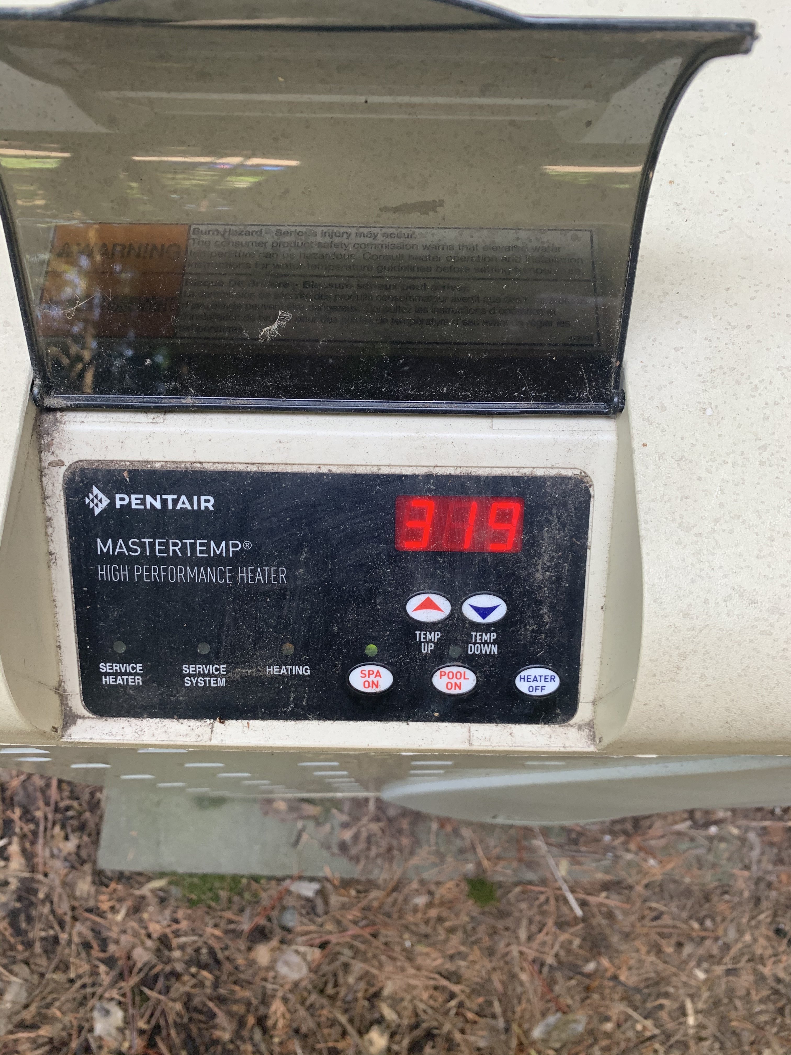

While running, press and hold the On button will display the exhaust temperature display.
Here is what the normal exhaust temperature should be:
  • Below 250 degrees...very low
  • 250 to 290 ..................low
  • 290 to 350.................acceptable
  • 350 to 480 ..................high
  • Above 480...................error/shutdown.
I've seen this done on other MasterTemp's, but doesn't seem to be an option on mine. I don't get the temperature read-out. I do have a thermocouple for my multimeter, and exhaust temp seemed to be around 380, so high. But invariably I'm not around when it gets high enough to trip off.

Well I have the five button panel, so it's not the "connected" version and no menu. BUT, also holding "Pool On" doesn't result in any display change?

The "Pool On" button works. I can switch from Pool to Spa modes. Weird. I just tried again, and holding "Pool On" doesn't work, but switching to Spa and then holding "Spa On" does. It's showing 428º right now (reinstalled old thermal regulator). Here are the "overall" system pictures. This is AFTER I switched the INLET/OUTLET plumbing on the heater.
