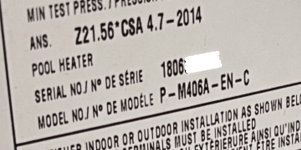

Current State - I cannot get my Rheem 406A with Honeywell gas valve to sustain heating. It heats for about an hour and then the flame strength peters out (starts at 8, runs for a while, then drops off quickly before the unit shuts off - unit then tries to relight but can't). I then have trouble lighting it again. The only faults I get are "No Pilot Sensed" and "Ignition Failure". There are no faults that have to do with cutting off the boiler. The pilot always lights. Sometimes, I need to jiggle the pilot around to get the pool heater started. The unit has 4.25" wc gas pressure before the valve, currently. When the unit runs, gas pressure drops by about 2" wc.
I have consulted this board frequently but cannot seem to solve my problem. I am uncomfortable spending the money to replace the heater because I am unconvinced that a new heater will fire and serve consistently. I would like some help determining this by being able to confidently determine why this pool heater is not firing and that a new one will fire reliably.
Original problem - flame rollout observed at the end of the season in 2022. Replaced the sensors but that did not fix the problem The 18-month saga begins:

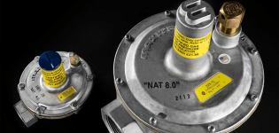

  7. I added a gas regulator to get the pressure down to 4" wc per the manual.

OK, this is very helpful, thank you everyone. I misread the manual on the 4" wc being the regulator at the valve. 14" wc is correct for the supply. As a quick fix, I adjusted the pressure to 6.5" wc and it is still not firing up.I will adjust to 10.5" wc this evening.
I acknowledge and appreciate that the heater is aged beyond its years and unsafe to run. I would like to get it to sustain operation for some time so I can have confidence that a new water heater will run. To this end, any ideas of why the unit will not light now? I would like to get a read on it while it is running so I can make sure it is between 6 and 10" wc while running. As a summary:

The regulator outside the heater indicates that you probably have 2 psi service to the heater and then the pressure should be a minimum of 6 in. WC and a maximum of 10.5 in. WC upstream under load and no-load conditions for natural gas.
The brass vent might be for indoors only, so you should check that as it might allow water into the regulator.
Vent limiters are used indoors.
Vent protectors are used outdoors.

i am only getting 6.5" wc because I installed a second regulator you cannot see. I am going to remove this regulator.
I will replace the vent limiter on the regulator you can see with a protector.
