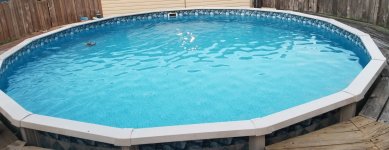

I wanted to give an update. I ended up removing the sand and replacing the drain assembly. I also had to replace the air bleed tube because mine was cracked then went ahead and replaced the laterals to spare my future insanity. After many hours and shedding blood, sweat and tears (literally), everything is working except for a few drips here and there from hoses but that is something I will deal with this weekend. I purchased the Polaris 65 and can't wait to set it up this weekend and watch it clean my pool while I sit back and have a cold one. I attached a pic but pay no attention to the non power washed side of my deck! Thanks again for the help!
Erin
