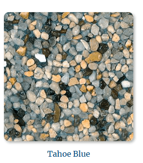

Your steps look to me like the Tahoe Blue sample found on StoneScapes Regular Pebbles Pool Finishes
The water color may change a bit once you have more CL in it and the plaster cures some. You don't have a lot of depth in the pool for the water to effect the color. You do have a bit more cream on the stps hiding the pebbles. Another acid wash may expose more of the pebbles.
Too many reflections as stated….Buy I believe the OP is concerned with the blotchiness in the steps. More of peoples missing then anything from what it looks. I wouldn't be concerned if thats it.
Yea, he said it was Tahoe Blue...
100098
I'm not sure if this is any better of a shot.
My concern is the somewhat blotchy look of the colors at the bottom of the spa. It almost looks like it wasn't acid washed and it has a layer of the blue plaster still visible. At least that is what I hope is causing the finish to look not as uniform as the rest of it.
