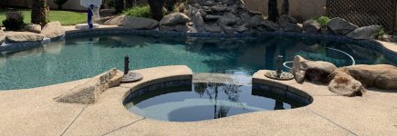

Can you show the whole system and the pool?
Sure. Attaching a few pics and an unlisted YouTube video in case that’s better.
Thanks!
