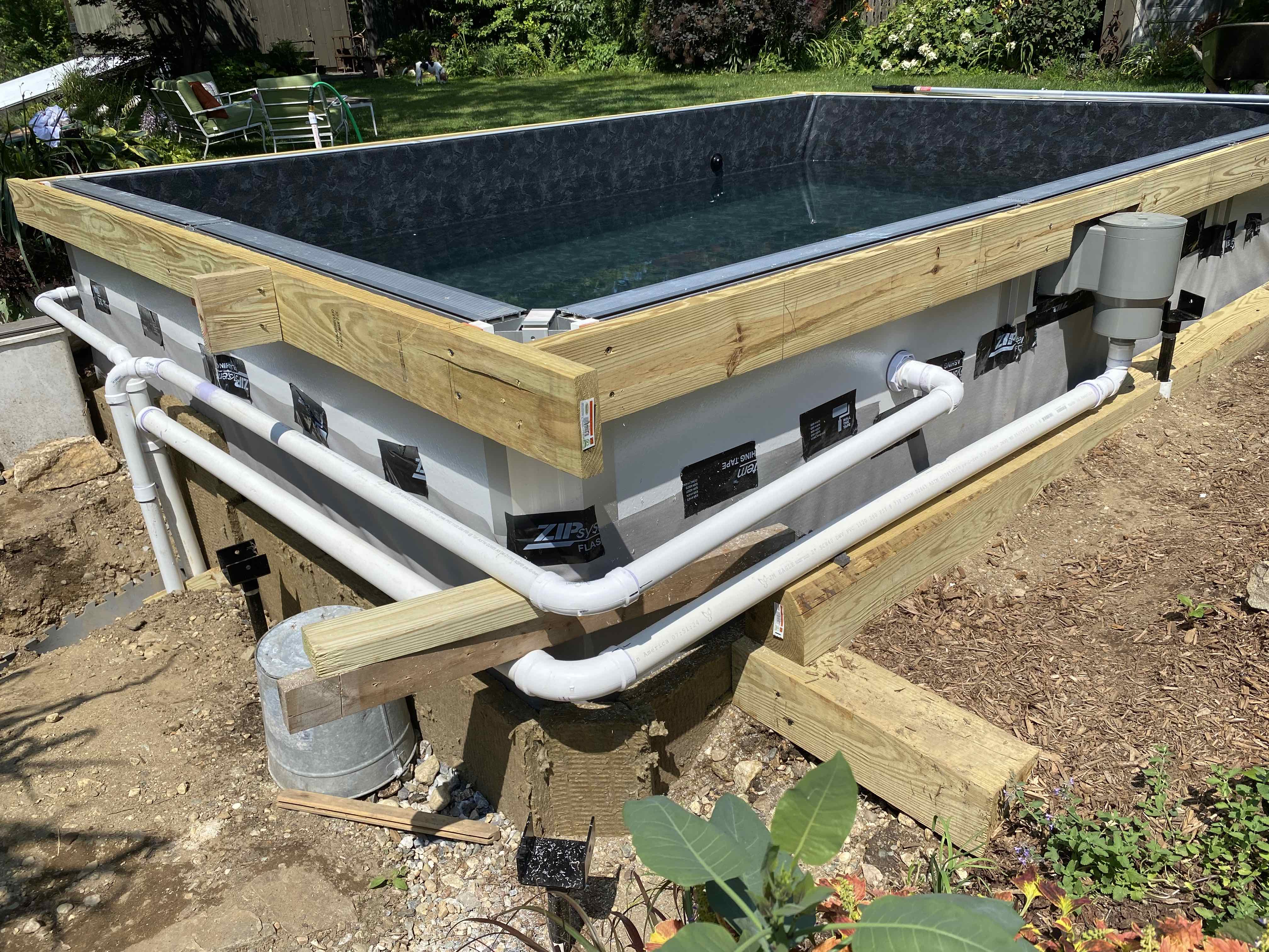

I just installed a 9-ft. by 13-ft. by 4-ft.-deep semi-inground pool with a vinyl liner.
A waterproof plumbing pad will be about 10 to 15 ft. away in a nearby shed where the floor is about 3 ft. below the water level in the pool—so all of the plumbing is slightly below the level of the top of the pool water, but above the bottom of the pool.
There is one skimmer and one return inlet on one long side of the pool, and there is another return inlet on the other long side. I'm running about 15-20 feet of 2-in. PVC from the skimmer, and I was considering running a dedicated 1.5-in. line for each of the returns.

I got impatient over the holiday weekend and went ahead and plumbed everything before I got your response to my questions (the family is anxiously waiting for the pool to be done with the hot weather we've been having).
Looking at your notes, I realize that I've made some mistakes. I'm prepared to reroute or replace anything I need to, and I'll get around to making some of the changes you suggested ASAP.
I started the pump yesterday, but every time I shut it off it drains down a bit and gets air in the system.
All of the plumbing is lower than the waterline, and the plumbing goes underground to get from the pool to the shed where I have the equipment.
I don't see any leaks, but I'll go back and tighten all the threaded fittings in case the air is coming in through a coupling, a cap, or through the pressure gauge on the filter (which seemed like it went in way too easily, even with a bunch of teflon tape on the threads).

  • the pipe from the pump to the filter is higher than the top of the filter. Is that a problem?
  • the anode is at the top of the pipe going to the filter, so it's an obvious place for air to rise to.
  • is there any issue with going underground and coming back up into the shed?
  • The skimmer has a 1.5" outlet, but the pipe between the skimmer and the pump is all 2". Do I need a skimmer with a bigger outlet?
  • From looking at the photos, is there any other red flag in how I've set things up?
(see photos below for reference)

I started the pump yesterday, but every time I shut it off it drains down a bit and gets air in the system. All of the plumbing is lower than the waterline, and the plumbing goes underground to get from the pool to the shed where I have the equipment.
Overall your plumbing work is excellent.
With regard to air leaks on suction side - always ensure the pump cap seal is well lubed and bump the cap tight with the palm of your hand when closing it. Also, there are 2 pump drain plugs - one under the basket and 1 under the impeller. Ensure those did not come loose.
The high loop may be an issue as on low speed the pipe is not being completely filled. Seeing the photo, you can either leave the pipe work as it is from the pump to the filter inlet and put a check valve before the pump. This would hold all the water falling back down when the pump turns off. Even though your pump is below water level, that loop is most likely trapping air. The alternative would be to reduce the height of pipework. My pipework from the pump to the filter, does not exceed the mid-point of the filter. So you could remove the ball valve from on top the pump exit and just make a short straight then a 90 deg turn to go around the filter. The easier solution may just be adding a check valve before the pump, if there is room.
I cannot see the drain line behind the filter. It appears to have a Tee fitting before it goes into the inlet of the filter.
The return side from the filter looks great. Really do not need a check valve after the filter (with the chlorinator) but it does not hurt. If you had an heater then definitely would need a check valve with a chlorinator. Appears it will be easy to install a SWCG in the future by removing the chlorinator.
There are many pools with 1.5 inch pipe from the skimmer that only goes to 2 inch at the equipment pad. You are better off with the 2 inch over the longer length.
Overall it is a good job, be wary of the those ball valves as they tend to fail over time and you have to cut them out. Replace with a 2-way diverter valve.
