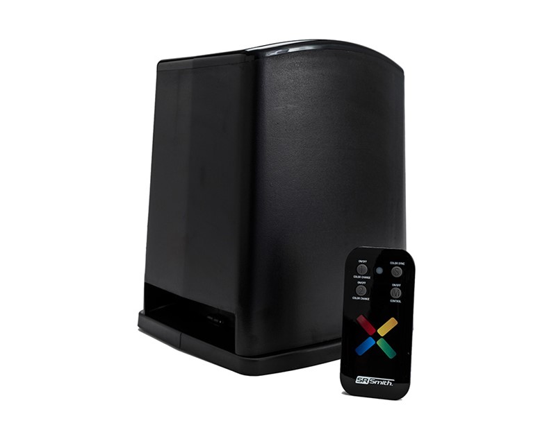

S.R. Smith Fiberstars 6004 Metal-Halide Illuminator is designed for fiber-optic lighting, and is built with a four-position color wheel featuring White, Blue, Green, and Magenta color options.
Made with high-impact outdoor-grade polycarbonate for weather-resistance and enhanced durability, the Metal-Halide Illuminator is built to last.
It accepts a fiber capacity of 450 strands and boasts a lifespan of 6000 hours, on average. Running on 120VAC and consuming 200 watts, is has a cool down/re-strike period of 2-3 minutes and includes a toggle switch for on/off control.

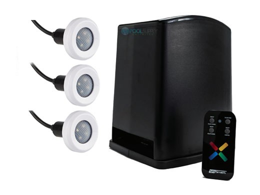

The portion in the pool is just a lens for the fiber optics, not a light. They are 1.5" FIP threaded ports that can accept newer LED nicheless lighting.

That lens will unthread from the 1.5" fitting. How many lenses are there in the pool? SR Smith makes this kit specifically to replace old fiberoptic lighting (which was never that bright to begin).
