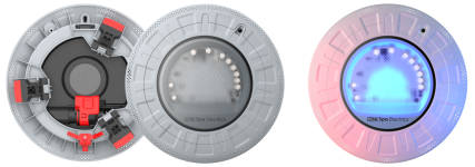

Edit - I just ordered 2 R10H lights from Spa Electrics. The "H" version is used exclusively for Hayward Shallow Niche LFGUY1000.

I would still consider the R10 (not R10H ) from spa electrics if you have a deep niche for just $130ish more than amazon light. You won't have to pull in a new cable now or whenever you need to replace it next time. It also has a 3 year warranty. The 2 year amazon seller warranty would be somewhat sketchy, imho. The R10 can also be programed to be compatible with Omnilogic light sequences. Good luck!
