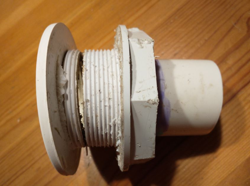

It is odd that you appear to be losing more water with the system on. That would seem indicative of a pressure side leak. :scratch: Curious, when the LD Co come out, obviously they appear to have done pressure testing, but did anyone actually get in the pool (or lean over), remove the jet eyeballs and inspect the return jet fitting inserts/threads coming through the wall? I had a tiny leak inside a return jet tucked up at the 12 o'clock position. If you simply plugged the return jet for a pressure test you wouldn't know if because the plug covered the crack in the threads. Only by chance did a tech double check and see a small crack in the jet. See below.
Interesting thought and I will look into it. I was unable to be home during the LD inspection, though I arrived home just as they had finished up so they walked me around to explain what they had found; I do not believe the tech had gotten in the water.
